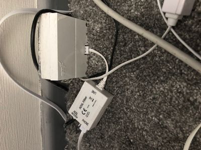

I have attached a photo of my BT box and the ADSL filter where I have connected the phone, just to confirm I dont need to do the test any differently?

Any noise on quiet line test is a problem as the test should be completely silent.
There is a thin white cable appearing to come out of left-hand side of socket where is that connected and where does it go?

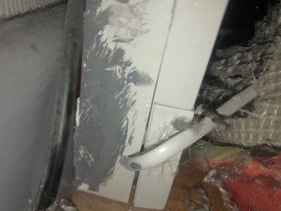

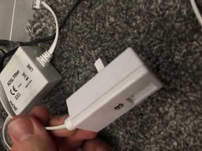

The cable does go into the left side of the box, on the other end is what appears to be another phone connector (when I plug the phone in it doesn’t get a dial tone).
I’ll upload pics when I’m back at my PC

Pics of the white box. The front cover of the white box is loose on this side as it isnt screwed in (the other side is). I dont know if this has always been like this or happened when the last engineer visited. :
