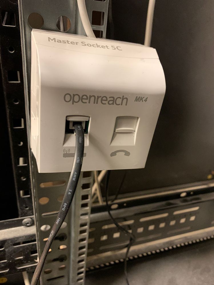

This is the socket that BT as installed which i've just noticed is the same as the other thread that is having connection issues.  However there is no micro filter in place before the router, the line simply connects straight to the router.  How would i get a micro filter in place or is there something else i can do to test whether this is causing the issue?
Thank you

@JaywR10
As you have posted a pic of the socket, you can "gently" remove the front part of the socket by squeezing either side of it, that will reveal a socket behind that face plate where you can plug in a Filter
More info - NTE5C_Instructions_CP.pdf (openreach.co.uk)
