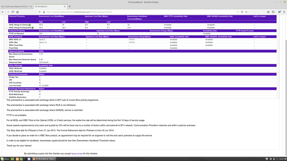

Thanks @imjolly . I've attached a screenshot of the BT Wholesale Broadband Checker output for my number, having scrolled to avoid displaying the number itself. I'm afraid that there doesn't appear to be a means of exporting the data to a .csv file or spreadsheet. It does appear that VDSL is available.
6,642 Views
Message 10 of 15
Re: Continuous Resets of SmartHub2: Copper Broadband
Go to solution
VDSL would be a worthwhile upgrade in your case. Also Openreach would be re-making all the cabinet connections to include the fibre cabinet, and that would eliminate any issue there.
