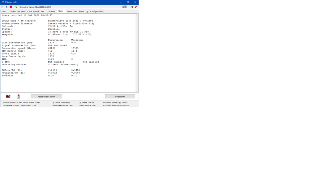

I've spent some time reading up about this and my conclusion is that G.INP should have kicked in for me by now. My service started on 12 June, used my own router and ECI modem until 29 June, when I swapped it out for an unlocked Huawei HG612.
I have both an ECI and a Huawei cabinet on my road across from the PCP cabinet, and my DSLstats say I'm connected to the Huawei cabinet. Line attenuation has always been 14.9 and SNR between 6.1 and 6.3. No noise on the telephone line and broadband is working fine, however I've never gone over 66 Mbps (occasional bursts during a speed test...and yes I know this is within the quoted range for Fibre 2).
As you can see from my stats G.INP is not enabled and my question is, will it ever? I thought the whole point of DLM and G.INP was having a stable line and then slowly upping the speed.
Am I banded...or just not getting the whole point of DLM/G.INP?
Any thoughts appreciated.

DSLstatsDSLstatsBroadband checkerBroadband checker

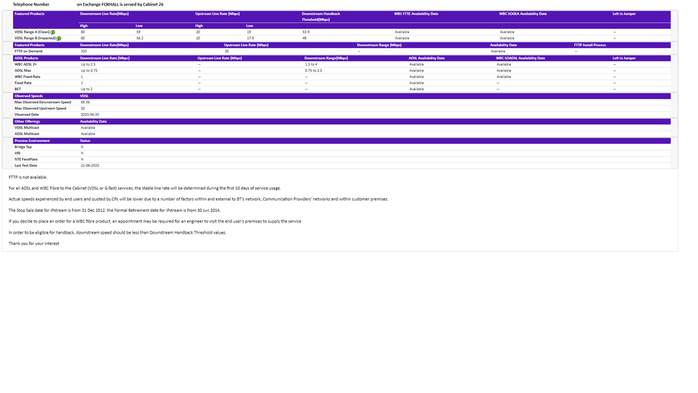

I have a similar setup where the ECI cab is the initial cab and then expanded with a Huawei cab but not sure how you can tell that you are connected to Huawei cab as dslchecker only shows cab number and both cabs ave same number. If you are assuming Huawei because of when connected then then that is not necessarily correct as you could be connected to a line given up on the ECI cab. The ECI cabs from a recent openreach publication in ISP REVIEW are getting G.INP rolled out but no dates given

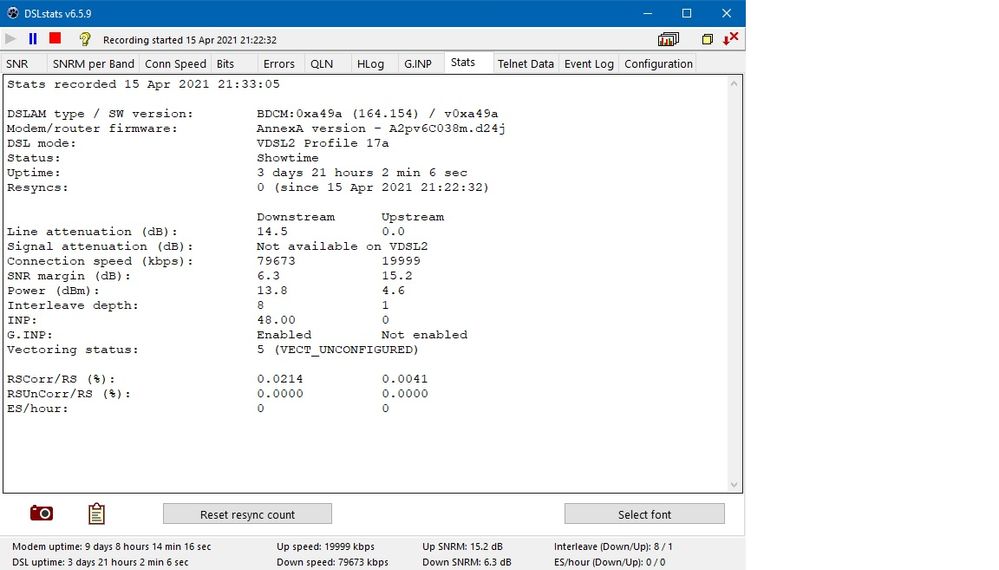

Thought I'd share as made me laugh....
Only ten months in and G.INP finally kicked in, not that I've noticed any difference in download speed, even though connection speed jumped from 69 to 79 (below), it remains steady at 65-ish.
Who knows, in another 10 months it could turn into FTTP 😂

If G.INP was active (though enabled) your downstream SNR would be expected at about 3dB.
8,155 Views
Message 8 of 9
Re: DLM/G.INP or not?
Of course G.INP has been activated, in this case in place of interleaving, thus his bump in sync speed and can be seen on the router stats (interleave depth as well as the GINP Enabled on the downstream status).
Sub 6dB SNR targeting only usually starts 2 - 3 days after G.INP is activated, and only if required to achieve higher sync speeds. As the OP is so close to target with just GINP active this may never happen.
Also, the most the OP will see DLM change his target SNR to 5dB which based on the current stats will see an actual SNR of 5.9 - 6.1 with an 80,000 sync and it's probably worth pointing out that this will actually reduce throughput as the sub 6dB profiles DLM applies adds Re-Tx High which will reduce the IP profile of the line and can sometimes persist.
Ipswitch, regarding the lack of change in your speed tests, it could be worth powering down the router for 5 - 10 mins and then powering back up as sometimes the ip profile can get stuck.
