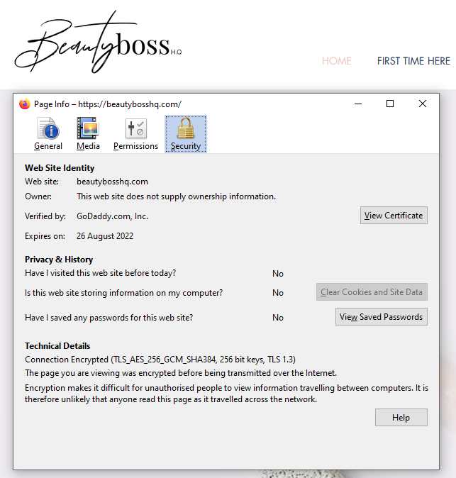

It has a valid certificate. I only get cert error when it redirects to incorrect address. Do you know a way to check the certificate that is said to be invalid?

I clicked on the link that you posted and I've not used that site before so I wasn't working on cached data.
I didn't check the IP it sent me to but there was absolutely no sign of a certificate at all (no padlock, or crossed out padlock nothing) so I'm thinking perhaps you have a configuration problem, maybe caused by the hackers.
