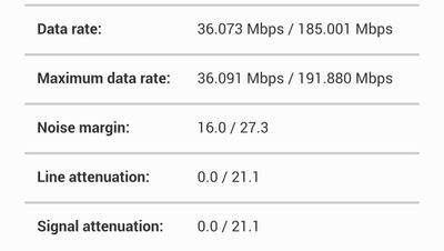

Hi all.

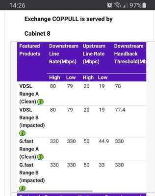

Just wondering, (ill post images) when I run the DSLchecker for my number it states I should be getting 330mb solid as im  10m from the cabinet.
 my maximum data rate used to be 400+ that has dropped 50% thus lowering my sync speeds, being my proximity to the cabinet and on brand new copper (12 months old) do I have cause to ask this be investigated?
 so from 400+ to 191.8 is more than 50% reduction. I know my line should be getting a much better speed than it is.
Thanks.

I'd report it as the noise magin appears to show an issue with the line.

So apparently there are no faults showing.
Noise margin as of now is 16/27
I'm guessing the DLM has set it to that for some reason. Im not to impressed that upgrading from fibre 100 to fibre 250 has given a 7mb increase.

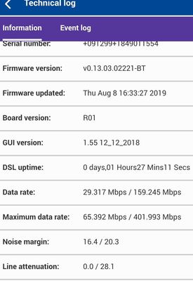

Found an image from my stats 2019 max data rate is 401 and a pinned sync speed nothing has changed either.

Now that noise margin is understandable due to the max available being so high.
