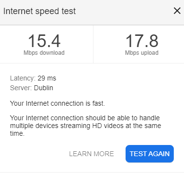

Go to solution
Thanks iniltous. Appreciate your help.
All the 3rd party speed tests are the same whether connected by ethernet or wifi:
I've also used SpeedChecker app on my phone and it shows the same as above.
If there's contention I'll get about 16MB down but it never, ever rises above 20.
I actually spoke to the value team and they regraded my contract in light of the issues I'm having but my maximum speeds are still supposed to be 67Mbps up and 18Mbps down. The person I spoke to at BT said it would be the same as ceasing and reproviding but I'm not sure if that's the case.
I guess they would need to send a line engineer out to do the DSLAM port switch? I don't honestly know if that's been tried yet.
