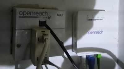

Hi, just had Digital Voice enabled, opened up the face plate of the Phone Connection but could not find  A nd B connection only had 2 and 5. I have an Openreach MK2 box, see below.
Where are the A and B connections located on my connection box and how do I disconnect them?
