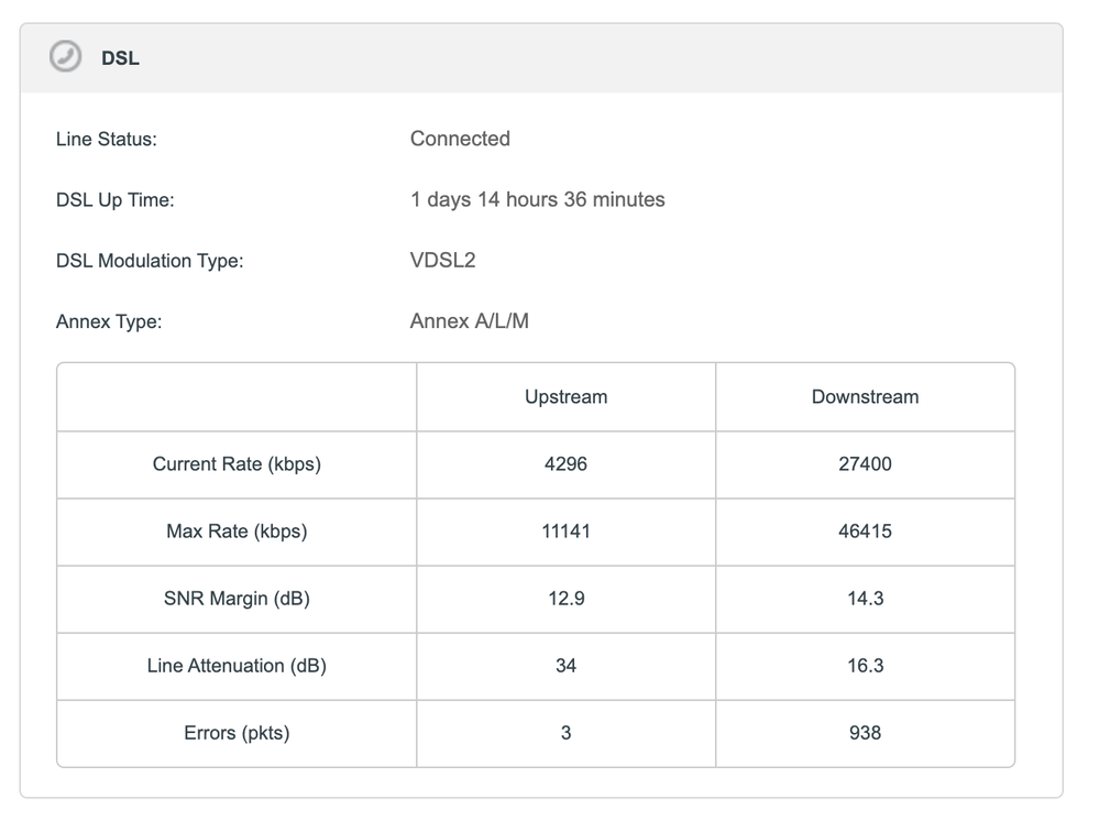

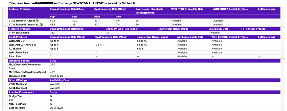

Whilst changing package won't improve your speed, if you have a line problem there might be scope for improvement.
Can you post your hub stats and the result from the DSL checker please. https://www.broadbandchecker.btwholesale.com/#/ADSL

Thanks....See the snaps 🙂

Re: Do I have to use by hub
As you can see from the stats, your line is capable of 46M but has been banded by DLM at 27.4M due to instability.
Is there any noise on your line with a quiet line test 17070?
Is your router connected to the master socket or an extension? Your speed is below the handback threshold so you can report the fault.
