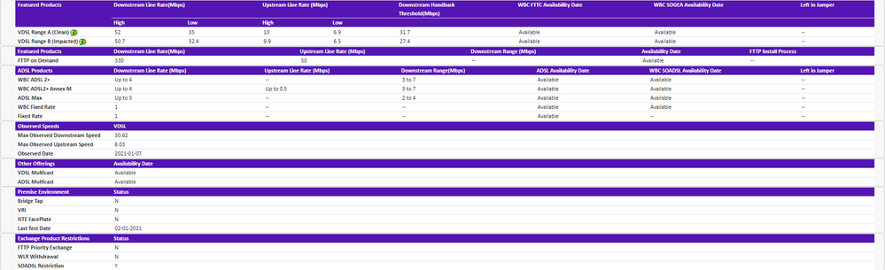

can you post connection stats from your router
Have you tried the quiet line test? - dial 17070 option 2 - should hear nothing - best done with a corded phone. if cordless phone you may hear a 'dull hum' which is normal
enter your phone number and post results  remember to delete number   https://www.broadbandchecker.btwholesale.com/#/ADSL

I use an Archer c50 router because the standard BT hub doesn't have QOS settings to alleviate latency issues
For the life of me I cant figure out how to get the line stats up, but I have no issues with the connection except for high latency spikes when something is being streamed (a widely reported problem atm)
No fault on the line according to the diagnostic bot
Quiet line test is fine
I understand your point about more people connecting to the cabinet but like I said I had double my current speed about 2 weeks ago, have always had 45Mbps since I signed up to FTTC and I'm still paying the same amount for a lesser connection, frankly BT having more customers while my connection gets worse isn't a good enough excuse
None of these are my fault, all I want is the internet I've been paying for for the last 10 years to be the same as it was 2 weeks ago

Lets just get one thing straight, there is no con involved. You either have a line fault, DLM has taken action due to line stability or thirdly crosstalk has suddenly increased due to a new disturber having been provided.
Without line stats, it is not possible to form a judgment of which it is.
