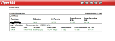

Well the new draytek G.Fast modem (uk version) has now been released into the wild and with my mt992 doing some odd things (random disconnects and the internet light going out even though i could still get online) i decided to get one and try it out, so far I've found it to be acceptable although its only been running a few hours and while ive seen posts that have said they have lost upload speed when they have connected it up i have not although its worth noting im on the lower G.Fast package.
The ui is very basic at the moment when running in bridge mode (it can run in router mode but has no wireless ability) and ive noticed that the system clock is not auto setting the time with no manual setup but i expect that to be sorted with updates (currently running 4.1.1_BT).
It has support for ADSL (not enabled in this current firmware), VDSL and G.Fast so i think can be considered a all in one replacement for those on VDSL but thinking of going G.Fast if they are not on the list for full fibre (yet).
A few shots of the info tabs....

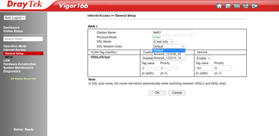

Something that caught my eye is there seems to be 2 G.Fast options, since i don't know what's what I've left as default...
