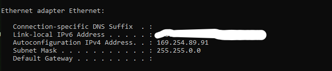

Thanks for the replies, these are the things i have tried
2 different computers
3 different browsers
fresh install of windows and drivers
cleared the ARP cache
I can manage the router interface both on  the TPLink router I  have and the BT homehub (when they are connected), and like I say it runs great in bridge mode, but I still cannot connect to the management interface of the Dratek modem. I tried the solution suggested by manually entering the ip in the IPV4 settings etc, however I cannot find the default gateway address with the modem connected (see pictures) , there is a default gateway showing with the BT Hub connected though.
Frankly I'm a bit lost now, does the modem have to be connected to the internet in order for the web interface to work. The interface should show when the cable is not connected to the wall socket ?

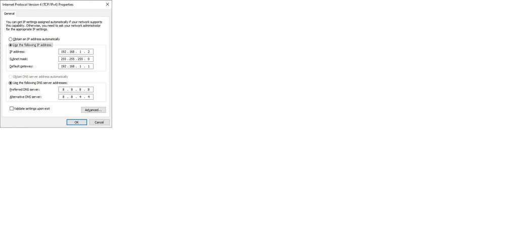

Configure your network adapter like this.

Ignore last post, just downloaded the user guide, it would appear the 166 uses  192.168.2.1 as its address in bridge mode.
Use these settings on your PC/laptop network adapter.

Licquorice is correct with the setup in his picture where he set the pc's ip to 192.168.2.2 however i would like to add that when i set mine up i connected it directly to the pc via its P2 port and bypassed the router/switch's completely.
Once you get the landing page (192.168.2.1) the login is the classic admin/admin but once in go to LAN/General Setup and it will let you specify a ip that will be used for all future logins (mines set to a high number) once done (mine rebooted) you can then go to System Maintenance/Administrator Password and set a new id (the login will then become admin/[whatever password you set]) at this point it can then be hooked up to the router/phoneline as its supposed to be and you can access it as you would any other device
I would also consider making a static ip listing for the ip you set in the router to ensure no ip conflict down the line.
