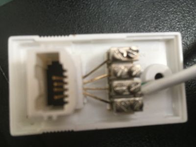

  hi.    Fitting an extension cable from the mastersocket to another room.  I’ve tagged the red wire to connector 4 and the white to connector 5.   The previous connector used these numbers but I’m concerned this must be different as I can’t get a dial tone.   Thanks in advance

Yeah. 2 outlets beside each other. Mastersocket 5c

I’ve a red and white wire to match with connector 2, 3, 4 or 5
any advice would be great

Sorted it
2 white and 5 red
working fine now but just want to check this is safe.    There’s a built in filter at master socket also
