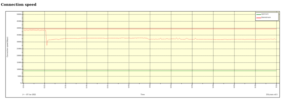

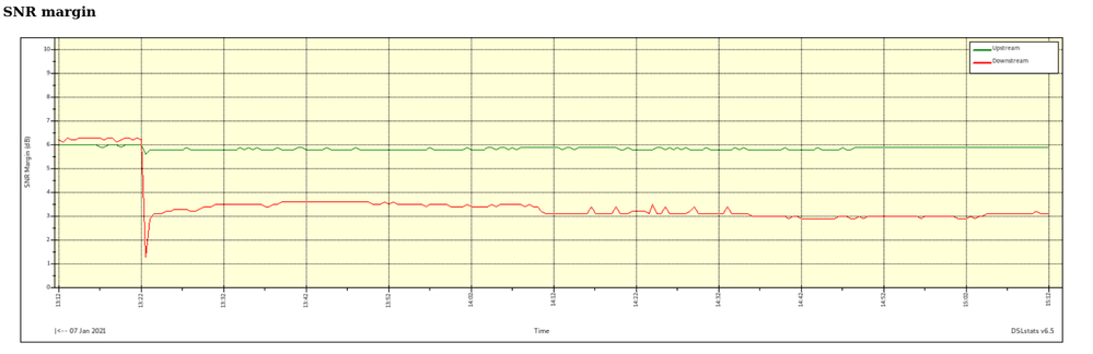

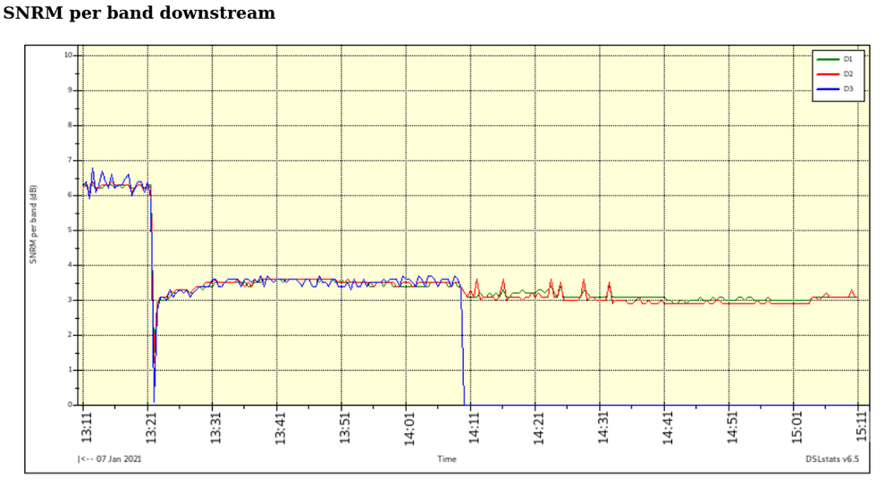

I'm in an unusual situation where my sync speed is more than my attainable. However recently I've noticed that one of my downstream band SNR has dropped to 0 does anyone know what would cause this?
I've done a noise test on the line - no issues
DSL stats below
Screenshot from 2021-01-07 15-12-18.pngScreenshot from 2021-01-07 15-11-58.pngScreenshot from 2021-01-07 15-11-47.png
