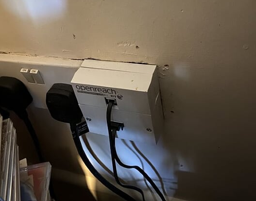

Latest is a text from Openreach with a video showing that they will not be installing extensions or other sockets due to Coronavirus.
So I'm fine with installing the ONT box by the front door where my first phone socket is and working from there myself, possibly resigned to having the Smart Hub there and use powerline and a gigabyte POE hub I have lying around for wired connections in the study.
The only outstanding question is whether they can do this if my current master socket is wired upstairs (as below) with a cable running up the stairs.  Is that just taken off the main line by the front door and does it matter in terms of where they need to install the ONT?
4,671 Views
Message 20 of 22
Re: FTTH with a master socket upstairs
The chances are that your present copper line will remain for phone calls for now. As for the siting of the ONT, speak to the engineer when he turns up. They do try to place the ONT where the customer wants it but there could be good reason why it can't be done. If you don't ask, you'll never know.
