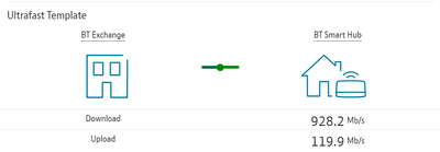

Managed to get an Openreach engineer out last week, they rebuilt the line did various other things that went over my head but were unable to see the Hub online, so it must be an equipment issue! 🙈  Kind of made sense though as I was unable to do a Speedtest through My BT as it couldn't find the hub.
Got back to BT, now able to see the hub online and able to do a BT Speedtest via My BT which brings up this
So the speeds are coming through to the hub.

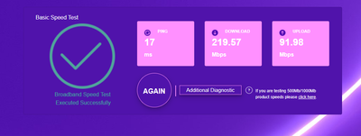

However, when I do a wired speedtest on BT Speedtest I get
Wireless is around 100, even when stood directly over the hub!
I seem to be going round in circles here!

I think in a previous comment you have demonstrated that your Hub is getting the correct speed so there is no issue with the speed getting to the hub.
It could be that the speed tester you are using is not designed to test higher speeds or that your devices are not capable of clocking higher speeds.
Devices can suffer from performance issues which can also impact the result you get when testing from a device.
Just an observation from your recent comment, in the bottom right it asks you to "click here" if testing 500/1000Mbps services.

It's the BT tester that they recommend you use and the "Click Here" is just for information.
