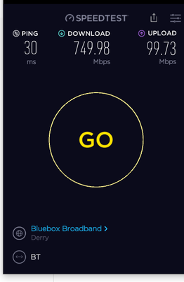

Still a very high ping ON Full Fiber to the Home with UltraFast
I have a ASUS Nighthawk Nighthawk X6 R8000 router plugin into my ont the router is about 2 years old though
I get good speeds as below but my Ping is still reasonably high is their anything i can do to help the cable i had was just one the bt openreach fella left in the ont. I just wondering why its so high when I have seen ones similar areas around 1-5 ms and sometimes 20-25 but i dont see 30 that often in most peoples test
Even at 43 I still game quite allot and the ping is annoying. Would buying a new router help u think

@busterboy1  yeah sometimes it a couple ms below like 28 or 29 but not ever below that.

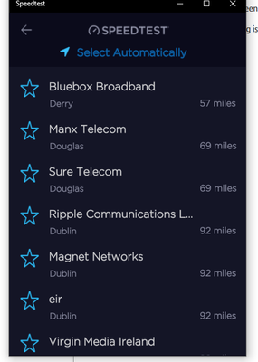

@JohnC2
As you can see blue box derry is the closest speed test area for me as I am from Belfast any suggesitons I saw your name in another thread about speed hope u dont mind me tagging please read orignal question with the type of router i have in my ont.

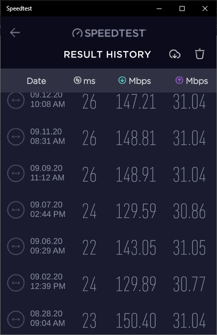

This is a few of my speed test results from the last couple of weeks, and to bee honest the ping rates are no different from when I was on FTTC.
All of the speed test sites I try give approximately the same results. So basically what I'm trying to say is that are these pings not what I should be expecting on FTTP?

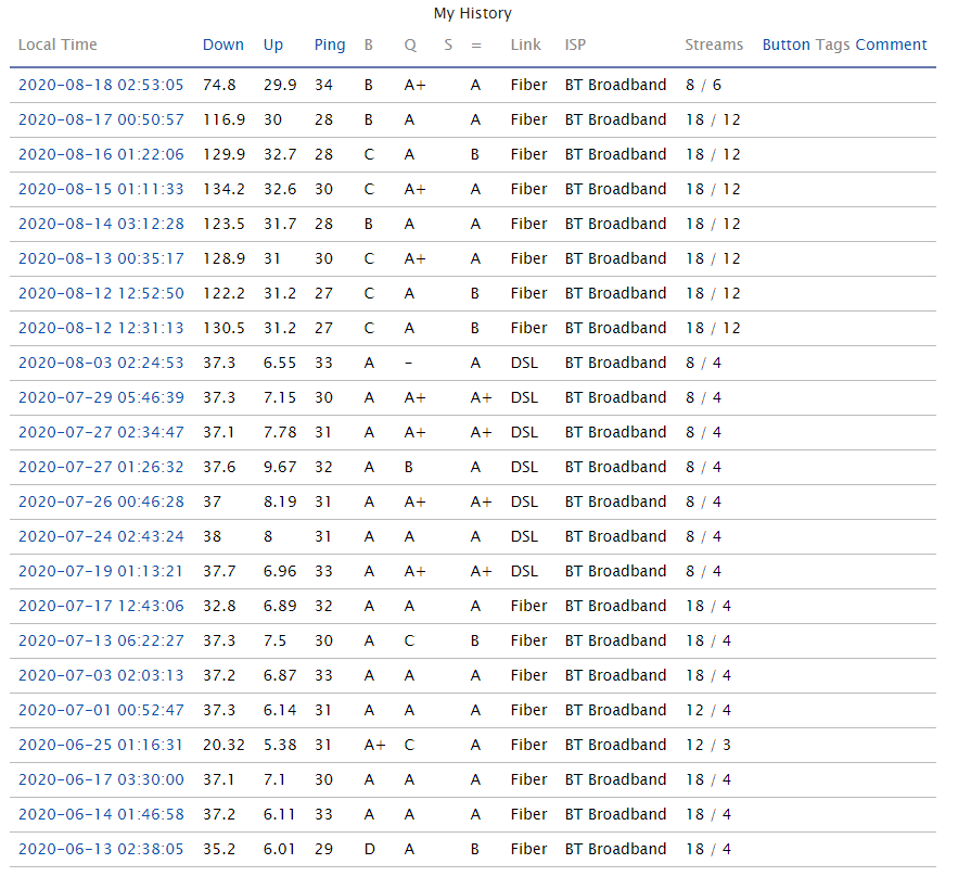

Re: FTTP High Ping 0f 30 but still good speeds
Sorry if I'm being a pain, but these results are taken from DSL Reports test around the time I changed from FTTC to FTTP
