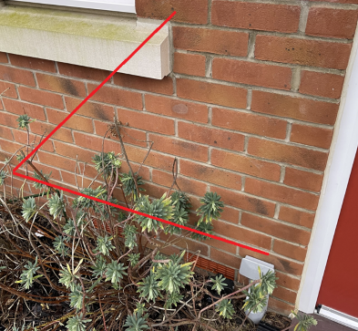

1. Here is where it all starts, the copper connection goes into the house here with front door on the right:
Outside of houseOutside of house

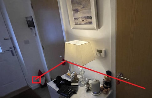

3 From here, it seems to go behind the downstairs toilet pan in some wooden boxing, then around the downstairs toilet and into the storage cupboard where there are ethernet sockets to my upstairs bedrooms. I have drawn some lines of where I think the route must go:
Outside view of cable runOutside view of cable runInside view of cable runInside view of cable runInside view of cable runInside view of cable run

‘BT Engineers’, aka Qube Communications Bodgers don’t do FTTP Installation Work. They work directly for BT Wholesale and aren’t allowed to work on the Openreach Metallic Path/Fibre Access Network.
It’ll either be done by an Openreach Engineer and or one of their Contractors, MJ Quinn’s, Kelly’s Communications or if you’re really lucky Pickr.
You live in what Openreach call a Retrofit Site, aka house built from the year 2000 onwards. I seriously doubt, in fact I can guarantee that Internal Copper Cable from the BT66b to the NTE is not in any kind of conduit.
If and when you have FTTP Installed the Fibre EZ Bend Cable will be surface mounted, which means along skirting boards and over door frames because they’re not allowed to run the Fibre Cable under carpets. The inner Micron Core of the EZ Bend Cable is 3mm thick and has to be stapled to the skirting board.

I wonder if I could find a way of taking off the boxing around the downstairs bathroom if they could do a new run and fish it through? At least there would be no right-angle at all, just a straight run from outside, through the bathroom and straight into the cupboard. Would be neater than surface mounting and I would remove the boxing so nothing for the install man to do.

Yep, that is the ONT you will have. Within reason the fibre optic can be run outside the house then enter at at a point acceptable to you, at which point the ONT will be put.
Best advice - have a clear idea what works best for you and let the engineer know. Tea/coffee and biscuits (chocolate ) have also known to be part of a successful installation.

Forget about paying extra or an engineer fishing through a connection. Concentrate on making the install as easy as possible. If any fishing is needed do it yourself and leave a draw string, make sure it moves freely with no snags.
Openreach engineers do their best to accomodate your wishes but there may be reasons why they can's such as bend radius. Thay will discuss the options with you when they arrive as you can with them.
