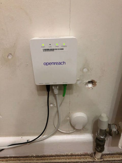

How thick is the fibre cable compared to the old copper? And any idea of the size of the ONT?

Perfect! Thanks!
