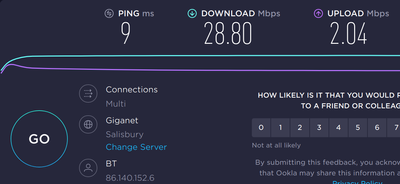

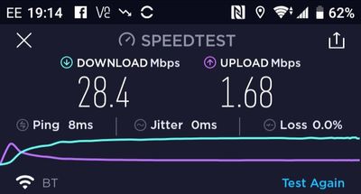

My concern is that real-life upload speeds are significantly below expectations and show some sign of throttling. It is easiest to show using a snapshot (as below, from speedtest.net). The purple trace shows the upload speed which peaks at around 5Mit/s (as expected) and then stabilises at around 1.7.
Exactly the same results are seen when carefully watching the figures on the BT wholesale speed tester, but in that case the final reported speed is the maximum number (today, the maximum reported was around 6Mbit/s, and is included below).
The result has been consistent over the last couple of weeks I've been looking, using a variety of modems, client devices on cables/WiFi, speedtest services, and at different times of day. Today I asked some friends who are connected to the same cabinet to run a test, and their results show a curve up to the max. line speed, so I have a strong feeling this issue is unique to this line or account.

your stats look ok and with 32/6.6mb are within your expected speed range when looking at the results from dslchecker. The btspeedtester results show download/upload speed as expect for conenction speed
speedtest.net looks like it was done using wireless not Ethernet

Hi imjolly, thanks for your comments. I'm happy you agree the actual line stats look good. Hopefully they should improve over time as it stays stable.
For completeness I performed the same test this morning over a hardwired connection  - the result is the same. An initial peak (numbers read 5-6Mbit/s but soon tailing off to a 2Mb continuous, slightly better than last night.
The result is the same when using the BT wholesale speed tester at https://speedtest.btwholesale.com/, only it doesn't produce a graph so it is harder to capture a meaningful screenshot. Also the same using speedtest.net but selecting different servers.
