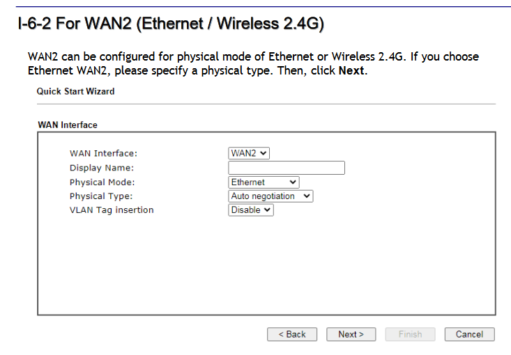

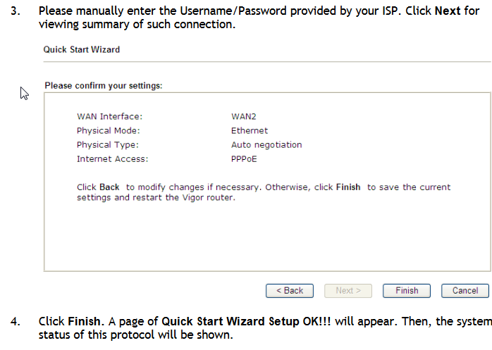

It should be simple. 4 steps in all.
2021-02-19 20_28_01-Vigor2100V_QIG - DrayTek_UG_Vigor2862_V1.7.pdf – Mozilla Firefox.png2021-02-19 20_28_21-Vigor2100V_QIG - DrayTek_UG_Vigor2862_V1.7.pdf – Mozilla Firefox.png2021-02-19 20_28_41-Vigor2100V_QIG - DrayTek_UG_Vigor2862_V1.7.pdf – Mozilla Firefox.png2021-02-19 20_29_07-Vigor2100V_QIG - DrayTek_UG_Vigor2862_V1.7.pdf – Mozilla Firefox.png
