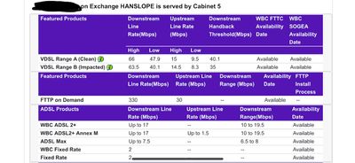

It appears that I’m unable to order Fibre 2, and BT believe my max possible speed is around 37Mbps, although my neighbours on either side quote that they are all getting speeds of 75-80 Mbps
checking on the DSL Wholesale checker from Openreach they seem to suggest that I should be able to get a much higher speed if I search with my address, but don’t seem to be able to search with my phone number despite having BT Broadband for a number of years.

You cannot use your phone number in the checker because you are on DV. Your address is the only way
did you try phoning options team 0800800030 and see if they can help you upgrade. Estimate is 66/47mb
