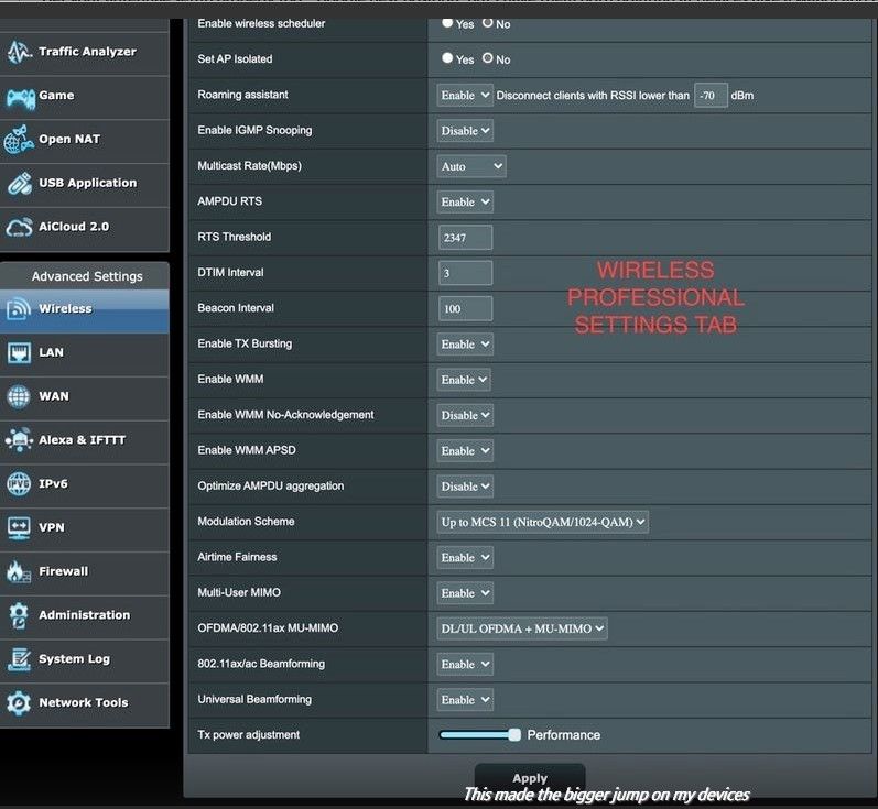

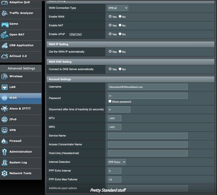

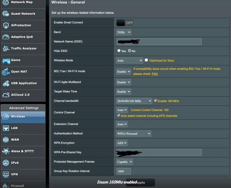

You need to take the BT Hub out of the equation altogether and try again, it is not needed if you are using the Asus AX router.
Connect your Asus Router direct to the ONT that is fastened to your wall.
Try these settings as posted by jedpause earlier, they work perfect.
___________________________________________________________________________________________
