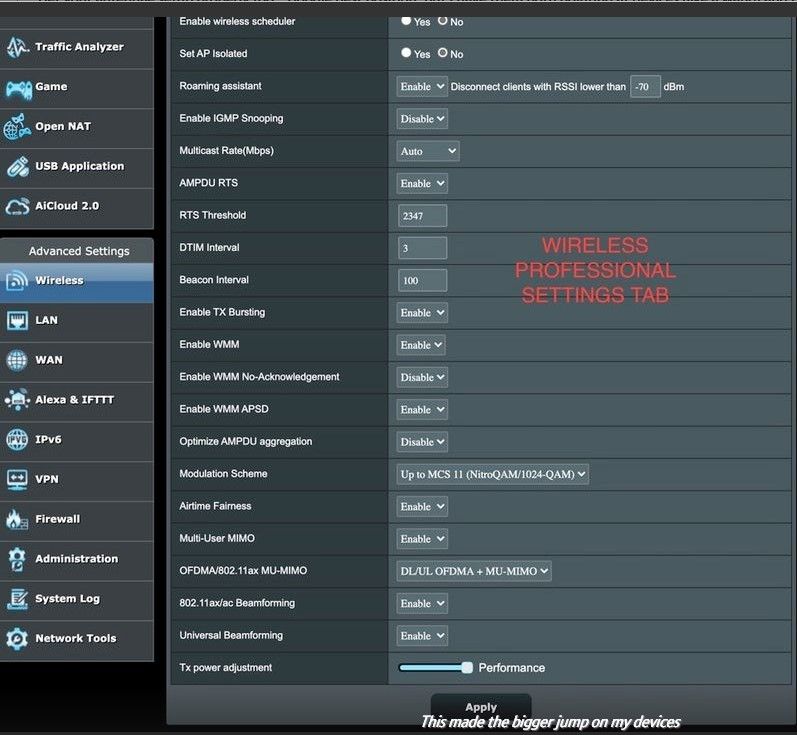

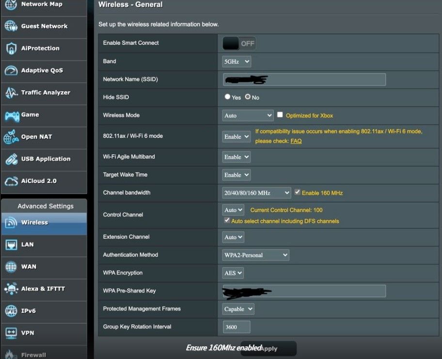

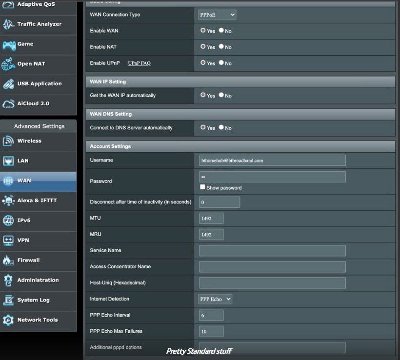

@PatrickMcDonnell
I have the very same router on the same 900 / 110 package getting full speed all day every day.
Try these settings although stock settings should work.
As @pippincp states setup a PPPoE connection first ruling out the router altogether.
