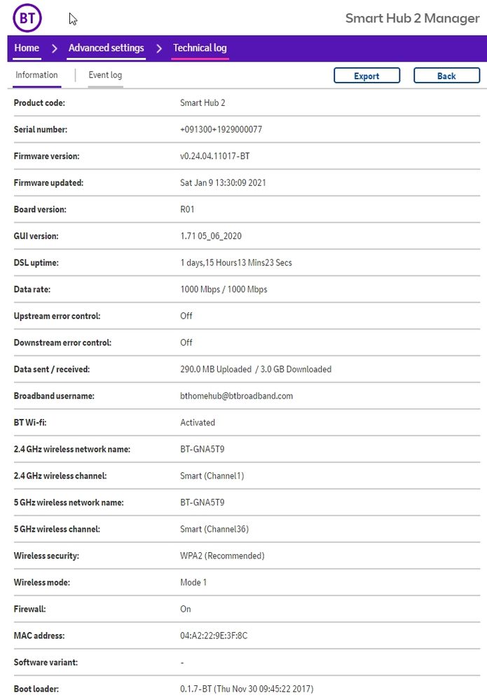

If you have a Home Hub 5 then click on Troubleshooting followed by Helpdesk on the management page of the hub and post a screenshot.
If you have a Smart Hub 1 or 2 then click on Advanced Settings followed by Technical log then post a screenshot of the Information page.

Hub Data Screen ShotHub Data Screen Shot

Ok, that shows you have an FTTP service, so unlikely to be a line problem. I'm confused with your other post which suggests WiFi is turned off yet you are having problems when connected by WiFi.
What speeds do you get when connected to the hub with an Ethernet cable?
