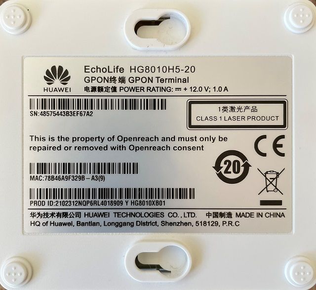

It appear that the KN Contractor fitted the wrong termination box in my home.  IMG_0319.jpg
The engineer who installed the FTTP at my friends home was about to fit this type of box above when he realised his mistake and fitted the correct box.  He went on to say that these boxes are not to be used. Note the maker? That leads to a question. Why is BT suppling these boxes to the contractor? Disappointing to say the least. Four months waiting and in the end no FTTP.  Thankfully I cancelled the order and obtained four months Halo 3 rental refund.

‘Why is BT suppling these boxes to the contractor?’
BT, BT who, BT Consumer? Or BT Supply Chain?
BT Supply chain provide 3 different types of ONT, or boxes as you call it at the request of Openreach. Huawei, Nokia and ECI. The reason being Openreach use 3 different types of Head End Equipment supplied by Huawei, Nokia and ECI and unlike FTTC Modems they’re not interchangeable.
It clearly says on the job what kind of ONT needs to be installed so if the KN Contractor who visited can’t read that’s hardly BT Supply Chain or Openreaches fault is it.
