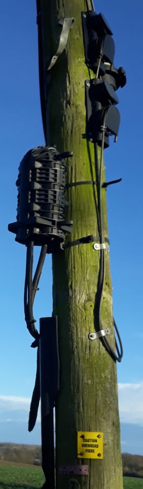

I am 100% sure the pole outside my house is Fibre (Caution Overhead Fibre labels on the poles), that it is owned by BT & that it is not a line paid for by a local business. In several of the local villages, FTTP is available.
This is the pole 3 up from the one outside my house - it is located at a T junction where one strand goes to the next village which has FTTP & one along the road past my property.

The photo does appear to show overhead FTTP, but if it’s not the pole that currently has your copper dropwire attached but 3 poles away , it could be of no use to you hence you not appearing to have FTTP available.
Your property not appearing on the list could be a mistake and your property should be included , or it could be correct , especially if your property is on its own in an isolated position and further away than the maximum pre made fibre dropwire available (AFAIK 300m) and the existing poles not usable to get the fibre to your home ( there is a maximum allowable span length between poles ) , so if for example the total distance to your home was less than 300m , but between 2 poles was 120m then you couldn’t be served without further network build.
The FTTP network isn’t BT’s responsibility but Openreach, you may be able to contact OR , if they check they may find that your property should be shown as available, there is a FTTP BT team , they may look at this for you if you are currently a BT Consumer customer.

Fibre does go from the pole in the image to the pole next to my house and away on down the road.
