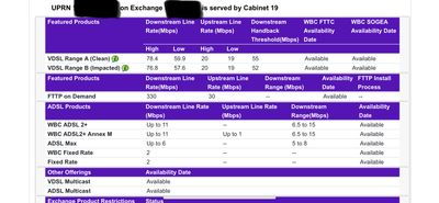

Re: Fibre unavailable at my property
Thanks for your reply - Hope these are the results you need.
Looking at checker you will be able to get FTTC.  You are going to need to get your phone line conencted first and probably adsl and once connected upgrade to fibre FTTC

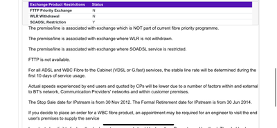

Thanks for your reply. Here are the results from the two properties either side of me:
The property is not a new build, just new to me; sorry for the confusion!
One of the agents I spoke to today did say they have received confirmation the previous service is to be stopped, and they tried to submit an order for both a new line, as well as taking over a previous line but neither would work. Perhaps as you say it could be a built in delay?
