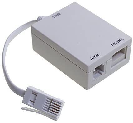

You just need to use a filter to provide a broadband and phone connection from the single socket. Blame the ASA for allowing FTTC to be called fibre broadband.

thank you for the reply, does the microfilter have lower speeds than the double socket?

No, it performs the same function externally as the the double socket does internally. You can always change the master socket for a filtered socket.
