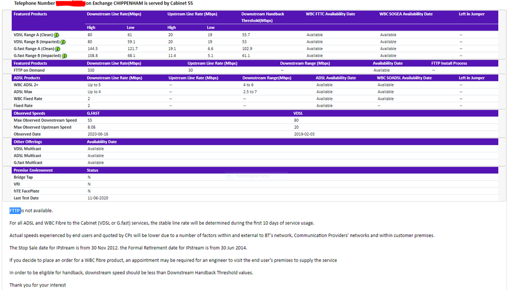

Once I am home later today I will post up the stats from the Hub, please can someone tell me where and what stats would need to be shared. Thanks

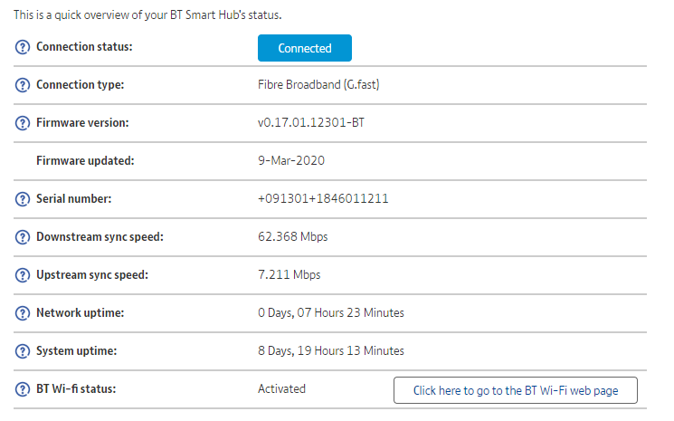

Longest its stayed up thus far.

Have added the technical information now
