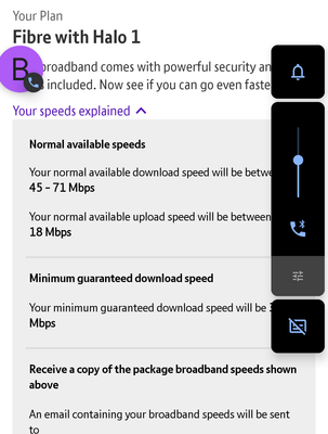

 fyi this is what I had under halo 1.. (excuse the volume slider in the screen shot, but the other screen shot confirms numbers).

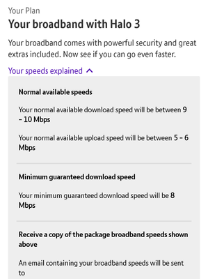

This is my predicted / contacted halo 3 speeds via the BT app:
 why such a drop?

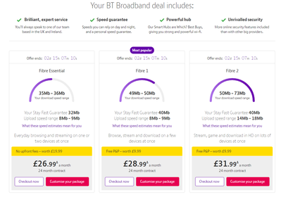

FYI an online check without being  signed in shows BT will offer my old speeds?
