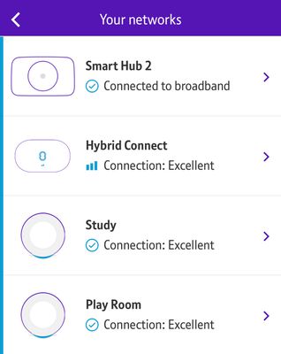

I just got the Hybrid Connect (Halo3+). My connection was two bars (96dMb+), good but not excellent. I purchased a couple of SMA antennas on Amazon: “Andven 4G LTE Antenna, SMA Male 10dBi Omni-directional External Antenna for 4G Router Trail Camera Mini PCIE Card - Black (2 Pack)”. I also pointed the device at the closest cell mast (using cellmapper dot net to find it), and played around with antenna position - went with both straight up. I’m now getting 91 dMb or less. Right now (which I assume is a low congestion time - Saturday morning) I’m getting 86 dMb. The icing on the cake, the status colour code has changed from green/good to blue/excellent in the BT app ✅
