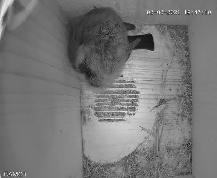

Re: IP camera
No, it's not that exact model, but it's basically the same as that one. All the settings are the same. And yes, it is switched on. In fact, I have **bleep** that has been sleeping in the box for the last week or so.2021.02.02 19-48-45.jpg
Why I was asking, was because I use Blue Iris here, to monitor all of my camera feeds, and as an experiment, I tried to add the camera to the program, but it could not identify the location of the video stream.
I have a couple of ieGeek cameras which are H264, and have very similar interface, and these are the Blue Iris video settings.
Its the port information and video path bit that I think was missing, as this normally defines the stream. In my case, there are two streams, one HD and one SD.
As yours is a public viewable camera, I dis not enter any login details.
I was just interested to see if it was possible to view it remotely, otherwise its going to be difficult for you to do much.
The 8999 is only the discovery port. You need to forward the actual video feed port number, for it to be visible. I think that is where you are going wrong.
Look at the camera setting you use when you view the camera, which port are you displaying, as its that port that will also need to be forwarded to the Internet.
