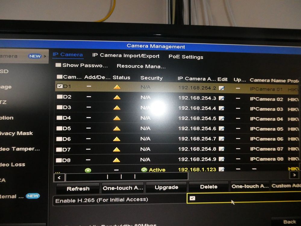

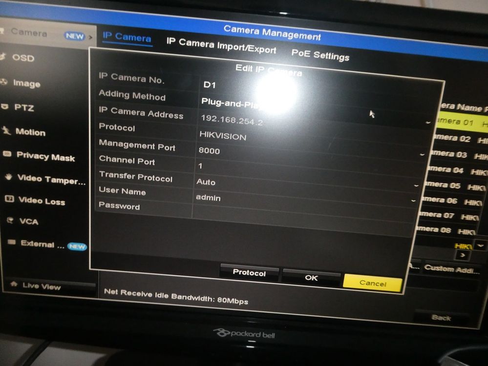

Keith, I've been having issues with my CCTV. I use a program called iVMS 4200 which I have installed on a couple of PCs. It enables me to look at my cameras, which are all Hikvision. This morning I decided to set the HiLook, NVR back to factory defaults. After watching some YouTube videos I assumed that I was just entering my new password, attach an IP camera and everything will start working. However, that doesn't appear to be the case. I took a photo of the camera settings. Does it mean anything to you?CCTV2-min.jpgCCTV-min.jpg

IP subnet is wrong.
It should be 192.168.1.xx
not
192.168.254.xx
No you can use the same thread.

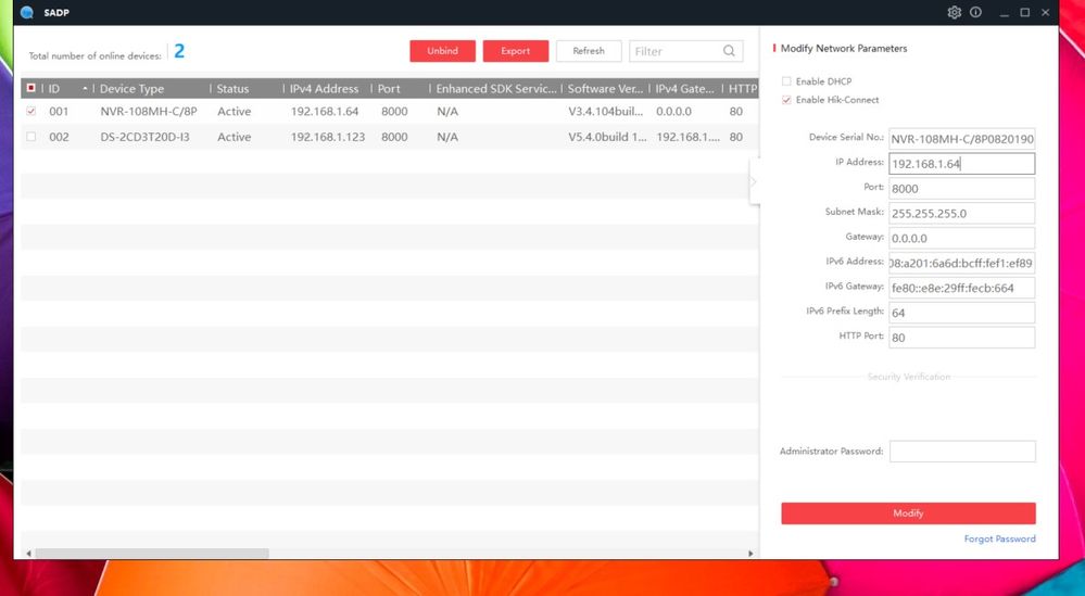

What I can't understand, Keith is why I couldn't just start from scratch after doing a factory default reset.
Are you familiar with the SADP.

You would if you had the correct IP subnet. It has to be the same as your own home hub IP range.
No idea what SATP is,
