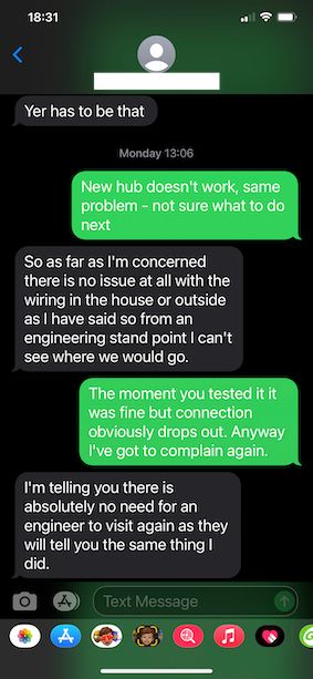

Engineer said line was perfect and it was hub. He said text him if issue still occurred. He literally only looked for 5 mins and the problem didn't occur while he was there. He really didn't want to know.
Fitted new hub Monday 12th issue was worse than before drops line constantly. Really couldn't work Monday and Tuesday.
Contacted engineer. He said to not bother complaining as no BT engineer would be able to fix it and all engineers would say the same as him. He said he was saving me the aggravation.
