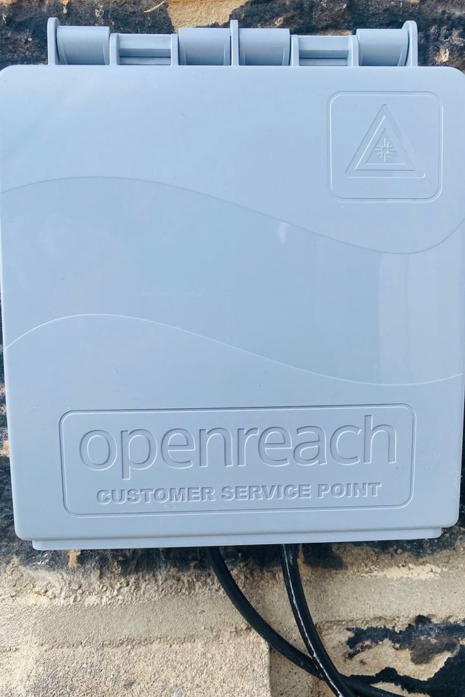

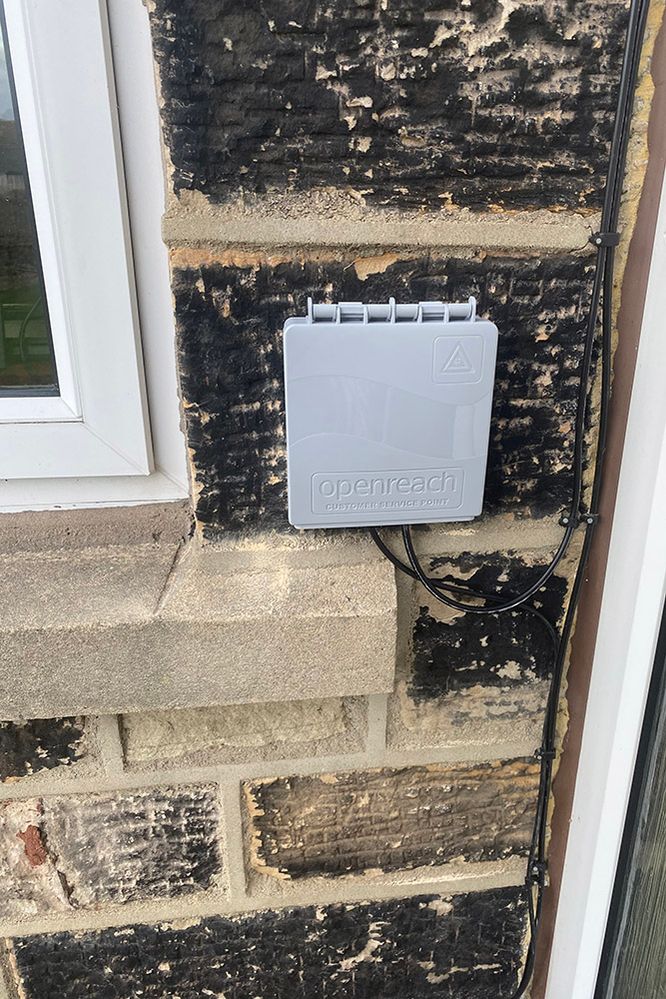

Re: Installation of new fibre broadband
@pippincp I see they must have changed the name on the product then.😋🤣

Openreach are notorious for creating acronyms and then changing their meaning or having more than one meaning.
You see on the older Legacy Blown Fibre the smaller version of them was called, Customer Splice Point.
Then it moved to the use of Field Fit Connectors for a couple of years before they finally accepted that they were absolute s#### and went back to Splicing using the ‘Inside Out’ Method.
This is when they brought out those new CSP’s and renamed them the Customer Service Point because they said that was the Openreach Demarcation Point.
But again that was probably dreamed up by someone whose never stepped foot outside the office because how can it be the Openreach Demarcation Point when the ONT remains the property and responsibility of Openreach.
