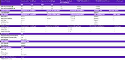

enter your phone number and post results  remember to delete number   https://www.broadbandchecker.btwholesale.com/#/ADSL
Someone may then be able to offer help/assistance/suggestions to your problem

Download speed via ethernet 0.8mbps when just checked.
Results from checker below:
