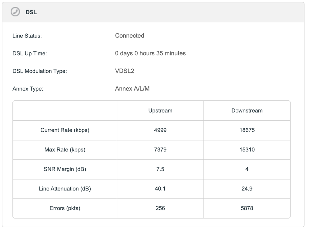

So BT have gone out again and done something (no information to what is being done) and my download speeds are dire.
They have reported it as fixed (about 40 minutes ago) but Im getting worse speeds than I was before. Do I need the line to settle?
On a speed test I get around 7MB/s down - Will this get better over the coming days?

can you check you have a dial tone and if so can you dial 17070 option 2  should be silent and best with corded phone from test socket
your connection speed is really low as is max attainable

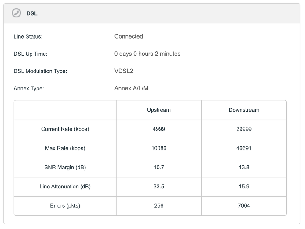

Thanks, Yeah I have a dial tone and the quiet line test seems, well quiet.
My internet just disappeared 2 minutes ago and my stats now show me going up in speed.. Maybe they are still playing around with it
