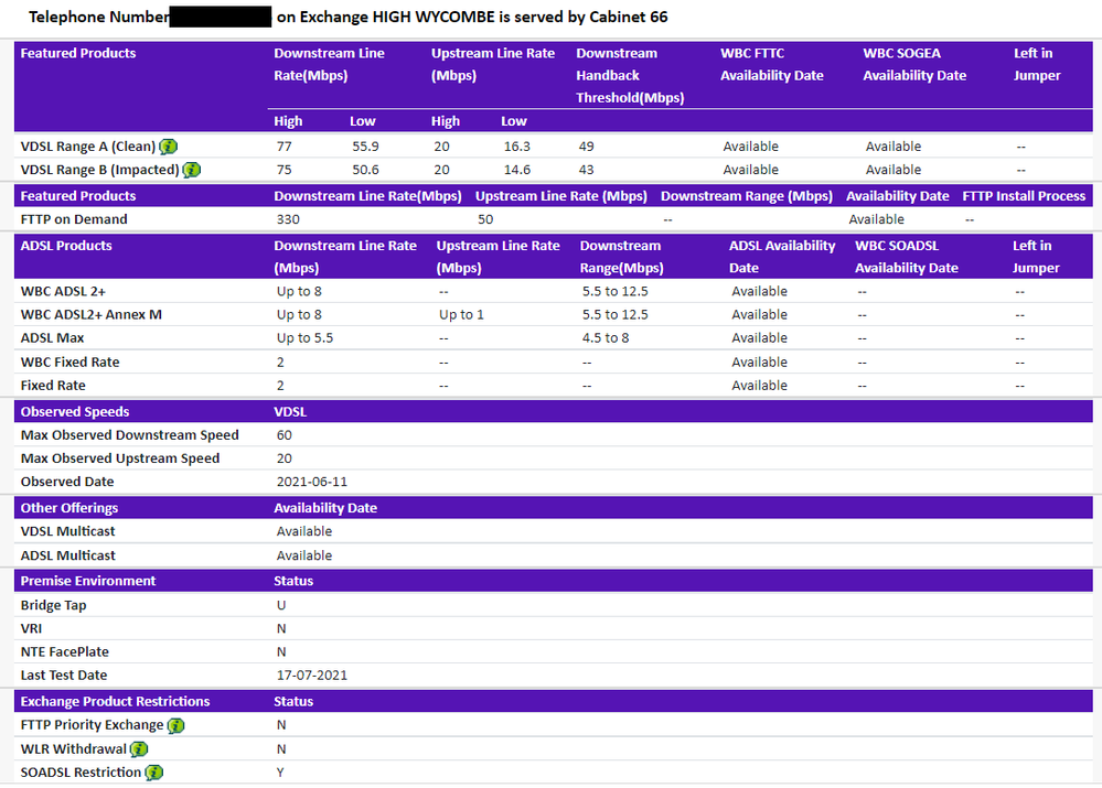

Enter your phone number and post results  remove number but leave exchange and can number
5,105 Views
Message 6 of 17
Re: Is DLM stopping the SNR target dropping?
Results from the checker below.  Sorry, I thought that I'd included it in my original post, but it got lost somewhere. 😞
The maximum attainable was around 68,000kbps about a month ago.  After a power failure it dropped to 60,000kbps again.  What's odd is given all of the other stats I don't understand why DLM is not trying to reduce the target SNR.

You just need to leave connection and as long as it remains stable then DLM should activate G.INP whi h will reduce noise margin to about 3db and boost connection speed.   This is automatic and cannot be activated manually
You are not in a banded profile
