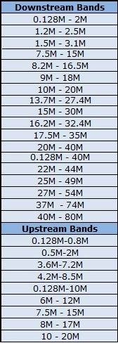

@japage33 wrote:
G.INP is already active on the Downstream.
For future reference, what are the banded speeds on the downstream side?  I sometimes get asked this by friends who use me as free tech support.
