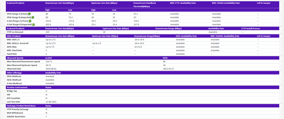

Has anyone got gfast and had any or most of the problems I've had? Or has it been perfectly fine? Should I just not bother and leave the connection as it is?ffdsfffff.PNG
Would I sync at 220mb download and 39mb upload on the higher package because of the observed date? Thanks.

Only you know if you need faster speeds, but unless it was just the Hub that was at fault, it looks as if its a 50-50 risk.
Its noticeable that your line might  have a bridge tap issue and I believe this is more significant with G.Fast (though thats pure supposition as it has U = unknown I now see)

Yes, I'm at the same house. Wouldn't a bridge tap issue effect FTTC as well, which has been flawless? The engineer who installed gfast said that the line was perfect. Other than the first one dying, when both hubs synced at 150mb+, they had all of the usual problems I listed above (unstable, erratic speed, buffering). So I don't think it was the hub that was faulty.

Who knows if you will have the same problems. VDSL2 is going to be a lot more resistant to noise so the fact that its stable doesn't really tell you if G.Fast is going to work well.
A 'bridge tap' can be apparently any connection to the cable, probably unterminated so you can get noise pickup and probably even reflections which would be more significant with the higher frequencies of G.Fast, so if there is a problem (your line has U for unknown) it might not affect VDSL2 but badly affect G.Fast.
The only way is to try it.
