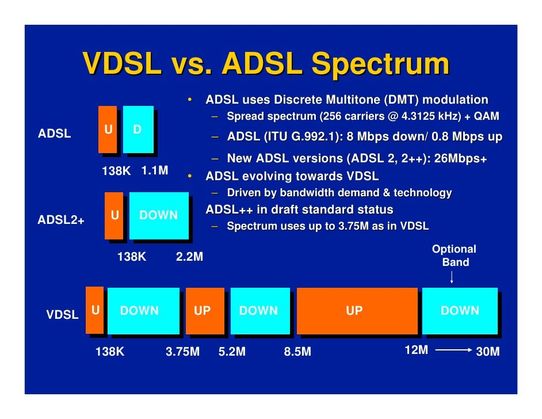

@navran
Its a technical limitation. Most of the upload frequency allocation is at the top end of the spectrum, and that has the greatest loss on a copper cable. You can see that the main upload allocation starts at 8.5MHz, which does not propagate very far without a lot of loss.
See diagram below. This profile is fixed.

Brilliant explanation @Keith_Beddoe !
