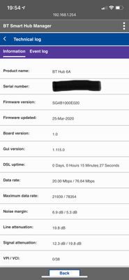

Is my SNR margin correct as I’ve had a few dropouts this evening and yesterday had another which caused the SNR on the right to drop lower than the one on the left, normally they’re both nearly the same with the left being a little bit higher I.E 6.4/6.9. I’ve only started getting dropouts since going over to fibre 2 from fibre 1

Stats look ok. Connection time only 15min.  Is that due to hub dropping connection or manual reset

Your SNRM is fine.
The default target is 6dB but it can be set to 5, 4 or 3dB to increase speeds more.
It can be higher than 6dB for lines that reach the maximum speed, giving a line "spare" SNRM.
The DLM that sets the SNRM is completely automated and can't be manually adjusted.
The SNRM is designed to fluctuate as noise (interference) comes and goes.

Can you try quiet line test. Dial 17070 option 2 should be silent and best with corded phone
when on fibre 1 your connection speed was restricted to 55mb but your attainable would have been 75/78mb which would give you a noise margin higher than normal 6db and that was fine
your connection speed is now just below attainable and gives the normal noise margin of about 6db. Should DLM activate G.INP on your line then conenction speed will get a boost and noise margin would drop to 3db which is normal for G.INP

The DLM is totally automated. The SNRM can't be manually changed on fibre.
If the DLM thinks the line is dropping too often it can cap the sync speed which will increase the SNRM.
You may need an engineer to look in to why the line is dropping.
