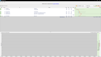

I have been experiencing lag spikes while gaming for 18 months or so now. They seem to happen every 20mins or so. Was with a different provider before (few month ago) and had the same issues. I believe the issue is ether in the cabinet or possibly my incoming phone line. I ran a test on ping plotter multiple times now and this seems to confirm this. Where do I go from here as my speeds are fine and using bt's line check they come back as fine.

Apart from the fact that there is no IP layer equipment in the cabinet, what leads you to believe that is where your problem lies.
There is no packet loss in that trace.

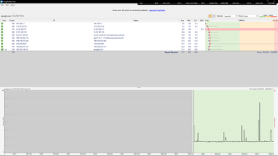

Sorry I attached the wrong photo.
I believe the below show packet loss on hop 3, which I lead to believe is from my modem to my supply from BT.(Although I could be wrong)

There isn't any actual packet loss at hop3, it just too busy to respond to your pings. If you had lost packets, there would be packet loss from there onwards. You need to read these plots backwards. Unless there is packet loss at the destination, there is no packet loss en route, packets can't be miraculously re-created.
Hop 3 is somewhere in the BT network, it is nowhere near your location. Hop 2 is the BT BRAS (Broadband Remote Access Server) which is located at a head end exchange. The green cabinet doesn't contain a router.
