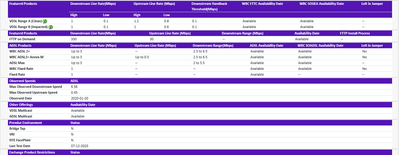

Enter your phone number into this form and display the results here, but edit out your phone number before you post the results.
4,530 Views
Message 3 of 28
Re: Line 'Upgraded' but download speed has been lowered and is almost unusable now
We were sent an email by BT saying our line has been upgraded. We never requested any upgrade.
Here're the details from the link

You are still on ADSL, if you had been on fibre 1 , your speed would be non-existent.
It shows your connection as 6.56mbs on 20th Jan this year.

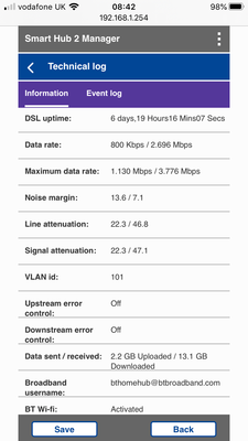

 Have attached a picture of the hub details.
Are these the details you need?

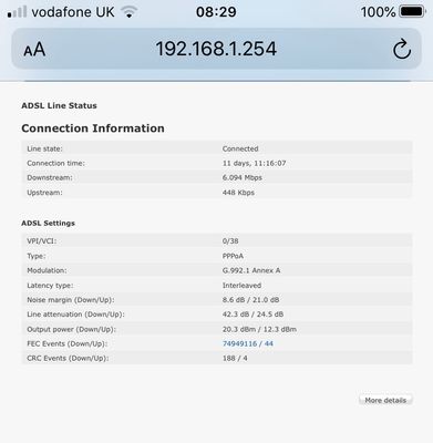

We do have another line that didn’t get upgraded and the stats for that are below
 Thanks

can you post the full stats page from technical log information
sure you only moved to adsl2 not vdsl?
4,450 Views
Message 7 of 28
We were never advised what we were being upgraded to.  Here’s the full stats

I would say you have been moved to Fibre 1 with stats showing connection type - fibre broadband vdsl and also showing VLAN id 101
that would explain the lower speed

In your case, its a downgrade, as you are too far away from the cabinet for Fibre 1. I do not think customer services bother to check, before offering free upgrades. It always a good idea to check before accepting an "upgrade".
There is nothing you can do about it, as I do not think BT will put you back onto an ADSL connection.
