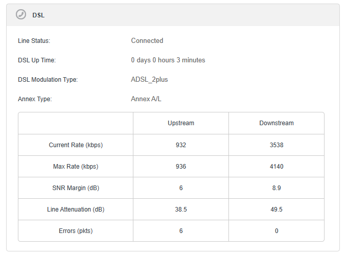

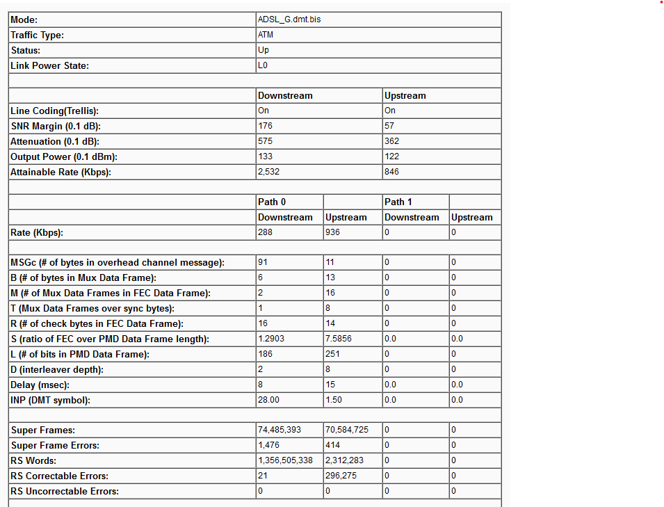

I use broadband only packages. No phone calls etc so only the routers are connected directly to the master sockets next to them.
1st Line where the old router was fried:

2nd Line (two pictures - one short and one long) where ADSL went dead and its master socket was replaced:
7,006 Views

how do both lines connect - separate master sockets
your stats are terrible     are you able to connect to the test socket which is behind the faceplate.  you will need a filter to use test socket and connect cable from router to filter and repost stats please

Yes I have two master sockets sitting next to each other.
Took both faceplates off and connect each one with BT filter.
1st Line - seemed to be returned to normal
2nd Line - the rate seemed to have increased although still struck at 288 kbps

The first line now looks ok.  I assume the master is one with 2 outlets - broadband and phone - and no filter needed
the second master is the same but your down speed is stuck in a banded profile due to the disconnections but this should now correct itself in 5/7 days stable connection
it is possible the master faceplates are faulty but both seems unlikely.  you need to make sure the faceplates are clipped on tightly as the can become detached and cause connection problems

Yes both master sockets have two outlets.
Even though the router stats for 2nd line is showing 288 Kbps but somehow the speedtest is showing just over 3 Mbps!  Seems the router stats is incorrect even though I refreshed the page.
Seems all is well now so shall I plug the faceplates back on?
UPDATED: Spoke too soon, although I haven't put the faceplates back on.  I found the 2nd router that did not have ADSL2+ enabled although ADSL2 was already on so I enabled it and then it got re-synced, got slightly higher rate and the profile is still with 288 Kbps. However, the speed back to very slow again.  Seemed to be a glitch with DLM?

you need to try and maintain a stable connection and DLM will release banding and speed will increase
I would stay in test socket for a few days let line stabilise and keep DLM happy
