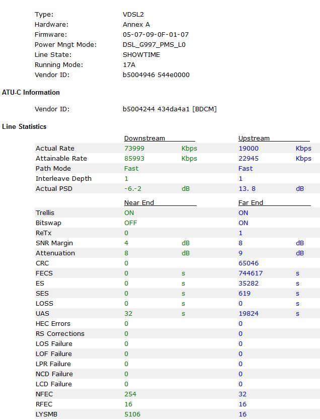

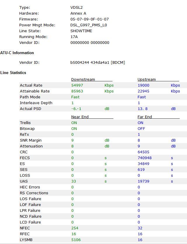

I was wondering if any mod is able to help me with a DLM reset on an inifnity2 line (Speed profile).
Local outages combined with some dodgy modem code and many reboots on my Draytek device seems to have thrown DLM into a tizzy. For several months now my line has been stuck at a low sync rate. 55Mbps. I have previously enjoyed 75Mbps+ for several years but DLM doesnt seem to be responding over time.
I'm currently set on a far side 8/9db SNR. Prviously the line has been stable at sub 6db at much higher sync rates.

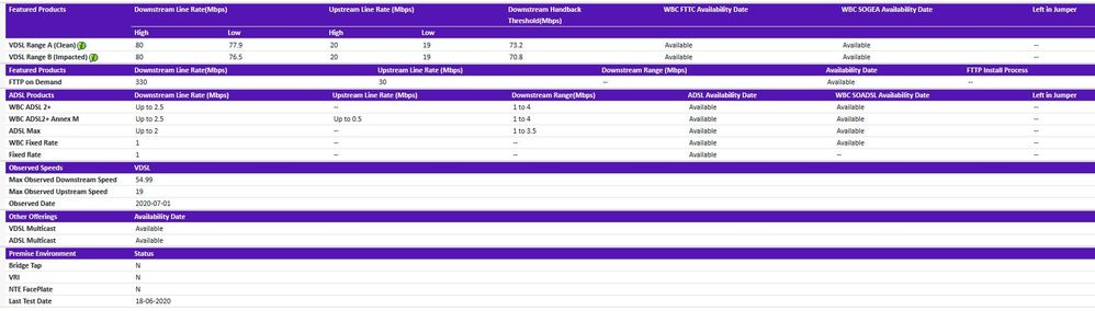

Please find VDSL line stats and cabinet stats attached below.

Well that was weird.
After a few months looks like DLM kicked back in and Draytek increased line sync by 20Mbps
If a MOD on this forum did anything, huge thanks. If not, guess I just got lucky with timing.
I guess I'll cancel that engineer call now 🙂 SNR margin back down to 4 so far with no errors. Lets hope it continues to 3.
