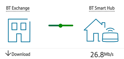

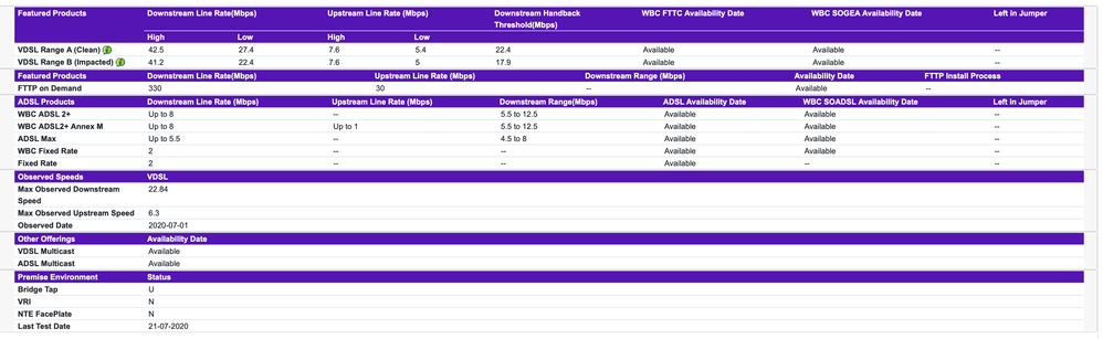

BT wholesale checker output for my number:
BT speed check results:

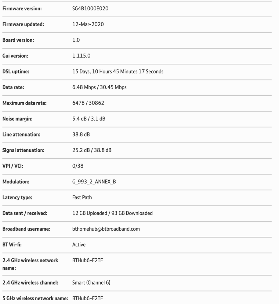

 And finally, information page from my Smart Hub:
Anything that seems out of the ordinary?

Your line speed is pretty much in the middle of the predicted range 22-42Mb being 30Mb,( 26.8 throughput on your test ) , so possibly not necessarily anything you can do.

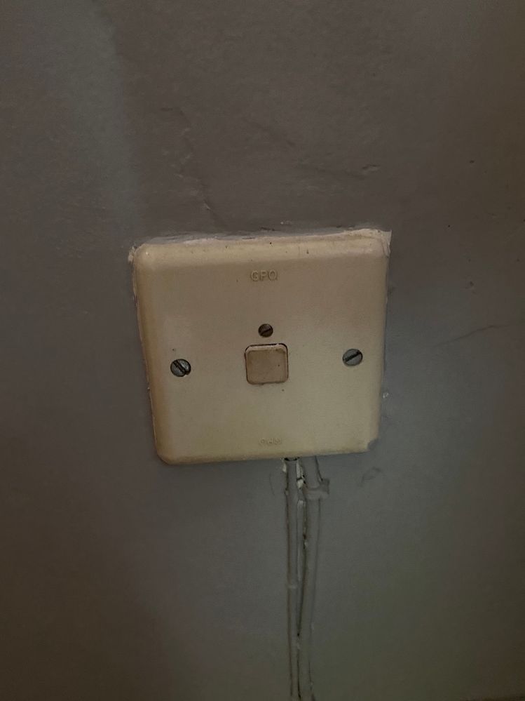

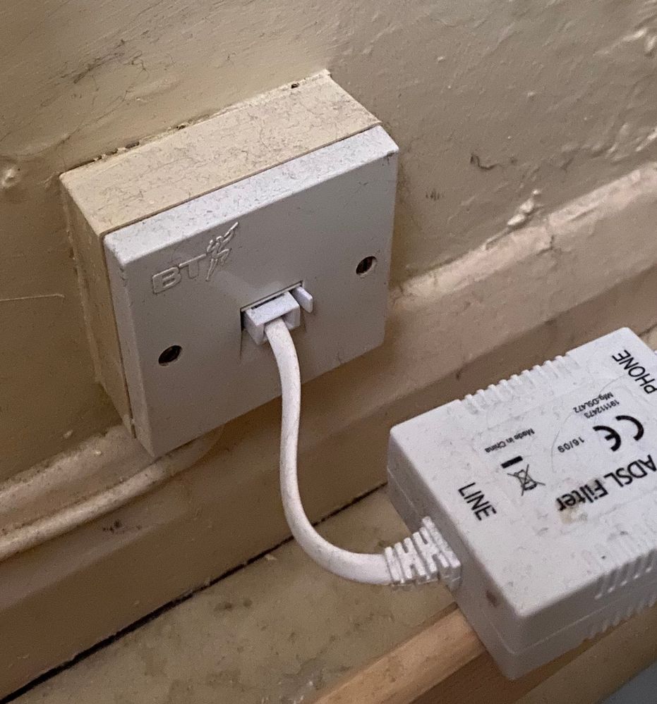

Not sure if this helps, but here are a few pictures of what it looks like.
The phone line enters the house and feeds into this socket/box:
The "main socket" (one of two in the house, both identical):

Wow , thanks for the photos, I'm 52, and I reckon this cabling is older than me!
I can't really give explicit help here, although others might, because the details of your precise cabling are unknown, and likewise I have no idea where your router is in relation to the cable entry point.
If it were me I would like to see a new (NTE5x) socket in place of your current cable entry point, but I assume that there would be a cost from BT/Openreach.

The socket in your first photo has 2 wires coming out bottom - is one wire the incoming openreach cable for outsideand the other going to you master socket which should be the first socket after openreach cable enters your home.  Or are both cable connecting to your  phone sockets  I will be master and other an extension?
