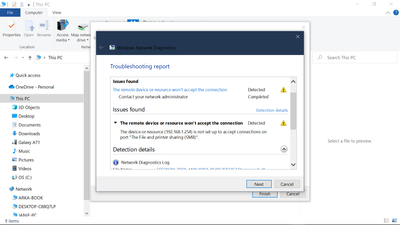

Hmmm, set to Private, SMB on at PC level, but still fails to map with the error message saying that the device or resource, 192.168.1.254... is not set up to accept commections on port "The File and Printer Sharing (SMB)".
Partner is now logged in to the hub to see if there are SMB setting on there...

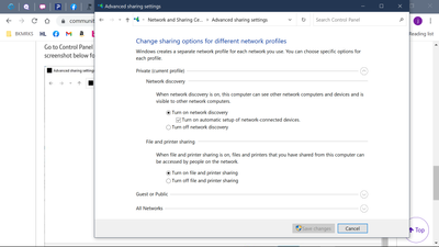

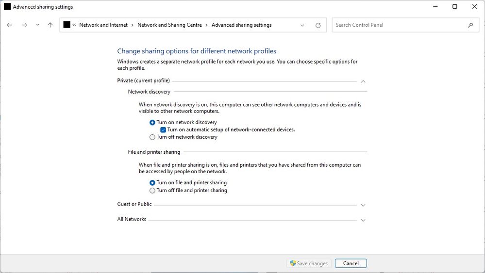

Go to Control Panel > Network and Internet > Network and sharing centre > Advanced sharing settings and make sure it is as screenshot below for the Private profile.
4,214 Views
Message 74 of 86
Re: New Smarthub2 and WDMYCloud connectivity
You are very kind and helpful, thank you so much....Mine, and his, are just the same as that...
