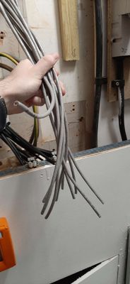

My flat does have a box inside the property for a connection. The cables I believe go out to the corridor and I can see a few dangling in the cupboard.
These are the cables the engineers have suggested should be connected to the Distribution Point. However the first engineer was unable to find which cable runs to my flat and I don't think the second engineer done that enquiry.
Is it possible that the Distribution Point may be somewhere else? If those are the cables, how would I go about installing a Distribution Point? As my lettings agency is not talking to me about internet, I'm not sure whether any works can even go ahead. They sent me an aggressive email when I suggested the landlord had not installed a Distribution Point.

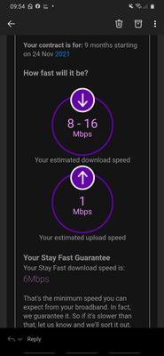

I have a contract start date they gave me.
I also have looked into a 4g connection but it's not ideal. I am finding that whenever I use a 4g connection speeds vary greatly per second and that I'm unable to upload and download anything at all at the same time. I thought a wired connection would solve some of these issues

In that cupboard can you take a picture of the floor for me please, all of it.
I want to see if any BT Approved Duct 54 or 56 exists in there.

If there is an Openreach branded phone socket in your flat ,  it begs the question , why, if the developer engaged with OR , didn’t they go for FTTP option as it’s zero cost to the developer instead of a copper pair service.  If the developer ran an OR type internal cable from the socket to a common area ( like a utility cupboard ) where are those cables , I’m not an expert but the grey cables in your photo don’t look like internal phone cables, and as already stated there would need to be a method ( usually a grey OR duct ) running to the outside of the building where a cable can be pulled in from outside, and connected to the external network , this cable terminating on an internal ‘DP’ (distribution point).
You probably need to have a discussion with the developer ( if still around ) or the management to see what provision was actually made ….if they insist that everything is in place , then you probably need to make sure that the building manager is available the next time the OR installer turns up, to show the OR person where the DP is, if there genuinely isn’t an OR DP, it suggests they never contacted OR to arrange connection to the OR network.
